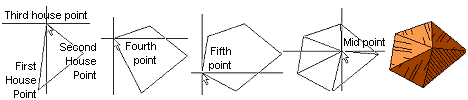

House Shape 8 (Many sided)
 This shape produces a polygonal house with as many sides as you like. The first three or more points determine the outside edges of the house. When the outline is complete, right click then select the roof vertex. This shape is unaffected by roof types other than flat roof.
