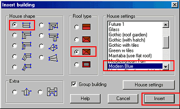

1 Start a house by select the house icon  . Choose a Modern Blue House Setting  (which is a 3 color scheme) with the settings as below.
