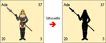

Creating silhouette counters
You can make a solid black filled outline of your character for use with counter templates. Build up your character in the usual way out of body parts on a suitable counter template. When you have finished it, select SILHOUETTE, then the character. The silhouette will be formed.
