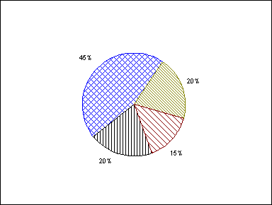

WEDGE is used to create pie charts. It does this by drawing filled arcs similarly to the ARCS-CENTER AND RADIUS command and providing means to quickly complete the circle.

The prompt reads "Ending angle [1st start, ESC=quit]:". The ending angle determines the arc length of the wedge. Type an angle or select a point when the arc looks the way you want. If you right-click, the wedge will be drawn in order to close the circle. Do not accept this default on the first wedge unless you intend to draw a circle.
CC3 draws the wedge counterclockwise from the starting angle to the ending angle
CC3 allows you to continue adding wedges, prompting again for "Starting angle:" and "Ending angle:". Continue to draw a series of wedges with the same center and radius. Note that the right button defaults allow you to easily draw adjacent wedges. Press the ESC key to end the command.
